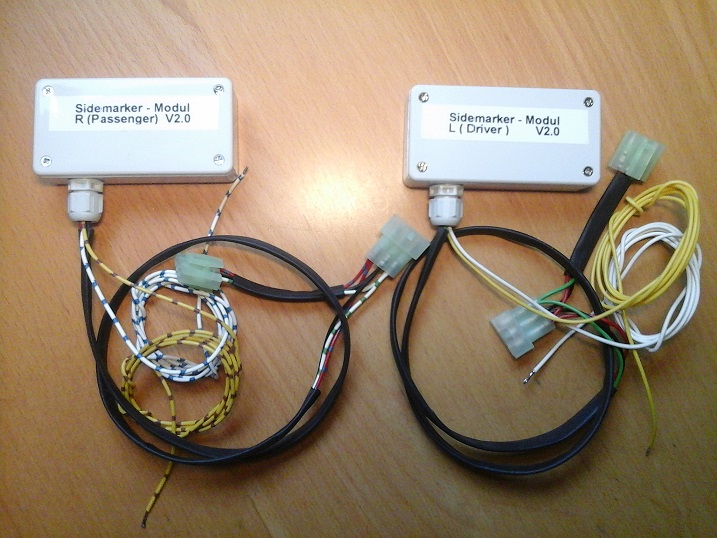

I combined the Function of the Indicators and the yellow Sidemarkers.
When you turn the Signal , the yellow Sidemarker will flash .
If the Indicator isn´t in function, the yellow Sidemarker will get in the "classic" Function back after 2 seconds.
I designed a Set of Modules which can be installed behind the Grille / DMC Emblem .

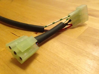

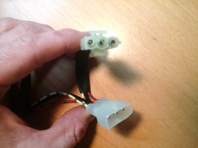

The Set is equipped with the original 3Pin Male / Female Connectors so you connect it between the Main Harness and
the Connector for the "Front Turn Assy"
Second Step is to connect the yellow Wires to the existing Front Sidemarkers and connect it.
With this small Fix ( 1h of work ) your yellow Sidemarkers will flash when you turn the Signal during the Lights are on
If you want to get the function every time ( even the Lights are off ) you had to connect the White Cables to the inner Space of the D and connect it
to an existing "Ignition" powered cable.

Almost Plug and Play. For step 1 and 2 ( 4 ) you will Need less than 1 hour with experience in soldering .
1.st Step:
The Box with the male and female connectors easy plug in between the main harness and the Front Turn Assy
( 100784 FRT TURN/SlDE LP ASSY Part 17 http://www.delorean.eu/catalog/index.php?cPath=19_26_60 )
The Connectors are 1:1 like the original 3Pin.

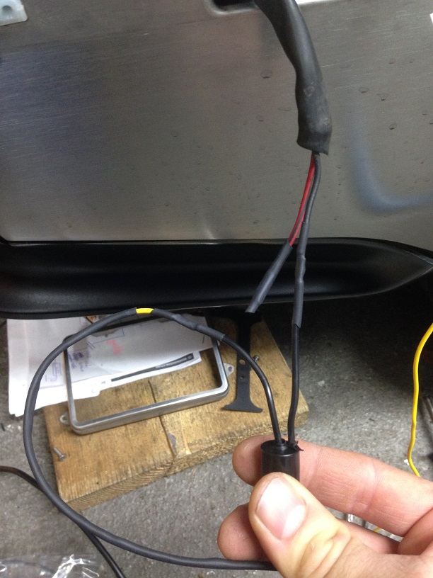

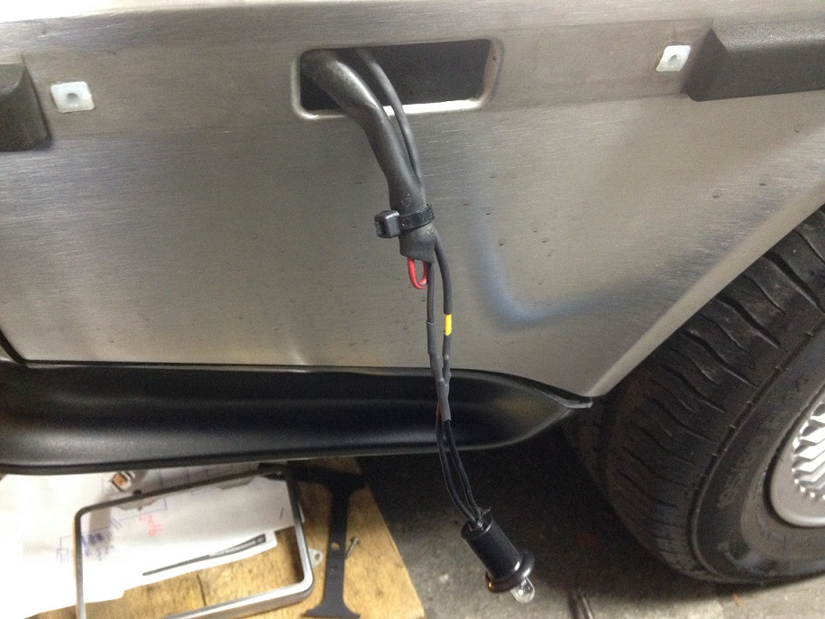

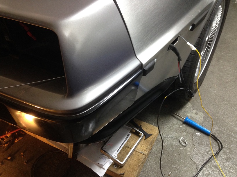

2nd Step:
Remove the H4 Lamps and install the yellow Wires to the Sidemarkers.
Cut off the Red Wire and sold the yellow wire . ( See the attached Images )
Install the H4 Lamps.
-> Now the yellow Siedemarkers will Flash when the Headlights are ON.
3rd Step ( Optional )
Every Box get a White Cable.
Install the White Cable on "Ignition" ( " 15" ) and the Sidemarkers will Flash when the HEadlights are on OR OFF.
It is an Option, so the Function is always active
In Moment i´m planning to make a 4th Step:
The Boxes will get a second function: Install a Mass Cable ( Black , 0V ) from the Boxes and you can Switch the Mass Cable on Ground
of the Car ( using a simple Switch ) and you can decide if the First Position of the Light Switch ( "Standlicht" in German, "Sidelights in English ? )
will be in the "US Style" ( FRT TURN/SlDE LP ASSY is yellow lightning ) OR the small Bulb in the H4 Lights are on.
I can send a pdf with a small install guide . Please send a PN with your email if you re interested.
Kind Regards Sebastian
